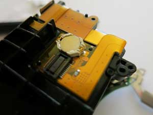

Your welcome and no problem I like doing this stuff, as an after thought I did a little more research. When you triggered those flashes you may have popped the fuse FU401 I attached the diagram for your G10.

04-19-2014 04:01 PM
Hi John:
I opened one G10 up againg to check the fuse on the FPC cable. It seemed fine - it has a small printed "J" on it. The second fuse on the same cable is okay too. When I opened the camera I was careful to discharge the flash using a analog voltmeter. It pegged the needed so it had plenty of juice in the capacitor - therefore power is flowing to it.. So I guess I am back to square one.
The camera works fine with no flash setting and with an external flash in the hotshoe. So if the flash capacitor had juice and the fuses are okay then I guess it is possible the flash unit (bulb?) itself is bad.
Other than taht it could be something on the mainboard that is broken, but that seems unlikely across two cameras. So maybe it a "secret calibration step" on the lens, that a rank amatuer like me cannot know. ( Or it's payback for even having the hutzpah to open the camera in the first place without factory training 🙂 )

Only the 1 fuse, F401 is for the flash the other is the one for the battery voltage, F402 and those are good.
