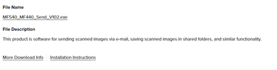

Late in 2021, Canon started providing an updated Scan to Email, Device and Network location Utility. Its a standalone configuration utility that does the configuration for you and saves the settings directly/correctly to the printer.
This is it here for W11.

Send to destinations are saved in the Address Book. I would use the remote UI for this, but am not sure of your comfort level.
You should be able to use the tool I mentioned above also.
