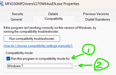

04-27-2024 11:59 AM - edited 04-27-2024 12:06 PM
1. Unplug your printer.
2. Go to Canon website and download Windows 10 driver.
3. Go to where the driver is and right click on it chose "properties".
4. Go to "Compatibility" tab and check "Run this program compatibility mode for:" then chose "Windows 7" from the dropdown.
5. Click "Apply" an close the dialog.
6. Run the app but stop on the first page.
7. If you never installed the driver before, continue and you are done.
8. If you installed the printer before then cancel the installation (you have to run it once to unpack its content),
9. Go to where you downloaded the app and you should see a folder created named similar to "MF4350MFDriversV270W64usEN"
10. Go to the folder, inside it into "misc" and run "DelDrv.exe". This fully delete the driver you installed before and restarts your machine.
11. Once your computer restarted, run the installer you downloaded again and you are done.
