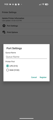

I think I mentioned this elsewhere but it's certainly something to try. If I'm not mistaken Windows uses Port 9100 by default, but the printer is set to use 515.
Try changing the printer's listening port to 9100. You can do this in the remote UI or from the Canon print app.
