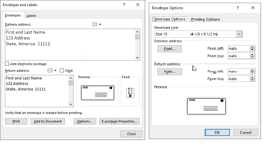

Open a new document within Microsoft Word. Activate the Envelopes and Labels Wizard by selecting the “Envelopes” option under the “Mailings” menu tab and fill in your mailing and return addresses. Select the “Options” menu to adjust the Envelope size and print position. Under “Printing Options”, you can confirm how your envelopes will be fed from your specific printer. On the Canon MF264DW the envelope is Face up.
By choosing “Options” you are able to change the look and style of your envelope. You may also designate your chosen envelope size and redirect your envelope to be printed from a different tray than has been automatically selected. On the Canon MF264DW it is set to Auto for use with the multi-purpose tray.
After choosing all of your settings in Microsoft Word, it is time to load your envelopes into the designated tray for printing. Place the envelope right side up in the center of the multifunction tray with the opening to the left. Place it in the middle with the bottom edge aligned to – A6. Select Print
