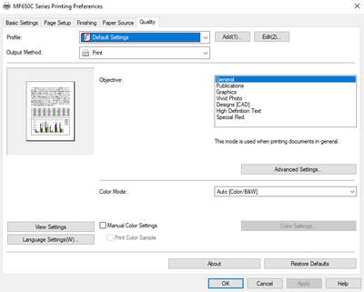

It seems that changing the printer settings seem to get rid of them sometimes. For example, I notice that high definition text with color will lead to the streaking. After playing with the settings, the streaking might disappear but after a few days, they'll come back. It's really annoying.
Would you happen to know if there is an optimal setting for text and graphics?

Is there a particular driver that you use? I've noticed that the driver can make a difference in the print quality.
I was speculating that increasing the resolution would make the image and text quality more detailed, but it appears that it ends up screwing up the color. I might be wrong though.
I wish Canon would explain specifically and in detail the dozens of settings do. For example, when changing from 600 to 1200 bpi, I wish Canon would explain how exactly the printer increases the resolution. Also, the pros and cons of each option. If 1200 bpi is better, why not always set it to 1200 bpi?
Right now, everything is explained in vague terms.
