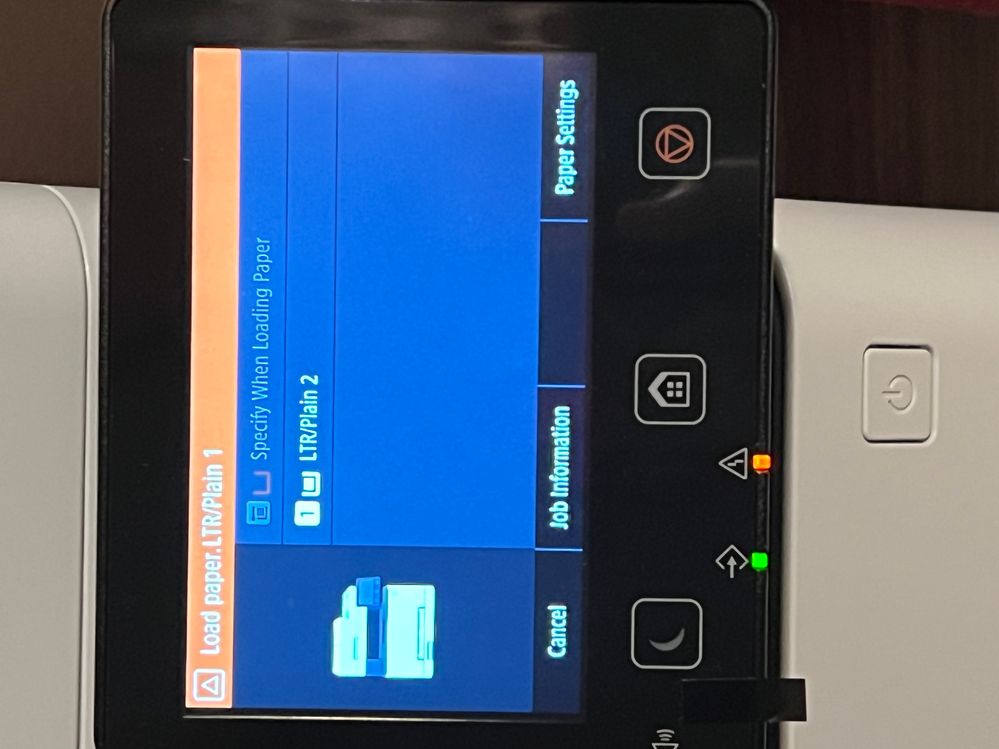

When trying to print from any machine (desktop, iPhone, iPad) the printer throws an error and fails to print. The remote user interface shows the unhelpful message "A maintenance error has occurred". Going to the printer, the orange error LED is blinking and the screen shows the following:IMG_8375 MF654Cdw Paper Error.jpgI'm not certain what's going on. Why does the error message say 'Load paper.LTR.Plain 1'? The drawer 1 paper size is set to 'Letter', and the paper type is set to 'Plain 2 (19-21 lb bond). I verified that the paper type is correct. When I touch the highlighted selection '1 LTR/Plain 2' the printing completes normally.
I would like to not have to physically intervene with the printer to make the print job start. Is there some setting that I am missing here?

Hello,
The error is showing that your paper tray is set to plain paper 2, but you selected the option for plain paper 1 when printing from your computer. To resolve the issue, you can select the paper type plain paper 2 when printing from your computer or you can change the paper tray setting to plain paper 1. You can change it by tapping on the paper settings option that appears in the lower right of the image you posted.
