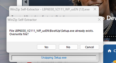

No able to get get new compuiter reconizes I have tried everthing since I bought new window 11 computer. Thius printer worked fine on old windows 11 computer after I plugged in and setup..  I have worked many hours and watche dmany videos and i ama t a loss to get printer tobe reconized and set up and prin on new computer. I have downloaded drivers several times  but keep getting same error message fille LBP6030_v2111_wp-USEN/bootup/steup already exists. overwrite file?     It won't let me oeverwrite file to run Win ZIP.. hate windows 11..please assist.

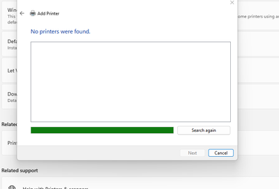

when I llok for printers in printers and scanners it says printer wasn"t listed not able to enter new device manuallu.. Why is this so difficult?

When you run the download, if it detects that you have already installed it previously, you'll receive a prompt letting you know that it's going to overwrite the existing file. Go ahead and say yes.
The file should run automatically but if it doesn't, go ahead and execute it.  It will be in your downloads folder and the name might be followed by a (1).  Do not connect the printer to an available USB port on your computer until prompted to do so by the utility.  The printer should be connected directly to a USB port on your motherboard. Do not use a hub, auxiliary port or an adapter.  The utility will prompt you to connect your printer.  You can do so when prompted.

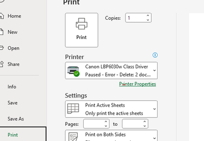

Thnak you. there is no Canon app that  is installed and there is printed that shows up under printers and scanners. But when I try to pry, it says Canon LBP6030w class driver  Pused error 2 documents waiting.. when I try to download drivers the same error message comes not allowing winzip to extract. is there a way to delete the driver.

it does not allow me to overwrite the file

You can't use the Add Printer dialogue because the printer is not connected.  You will not use the Add printer feature. If you have reconnected it before running the utility you aren't following the steps provided. Please review them.
Your computer believes the printer is present which is why it appears with two stuck documents in its queue.  This will prevent you from performing the installation procedure.
To clear the print queue, look at your keyboard, press and hold the Windows key and tap "R" (Win+R). The Windows key is near the bottom of your keyboard to the left of your spacebar.
This will bring up the Run dialogue.  In the Run dialogue type Services and press enter.  The Services applet will open.  Scroll down the list until you see the Print Spooler service.
Right-click on the entry and select Stop from the context menu.  Wait a few moments and right click again.  Now select Start from the context menu.  This should remove the orphaned jobs stuck in the print queue.
Now that the print queue is empty, the printer. Instance that exists should now be gone.
Review the list of installed printeers and apps and ensure no instances of the printer remain and that all Canon software has been uninstalled.  You said you didn't see anything previously but please double check. Restart your system again.
You should now be able to run the Installation utility and select yes when it prompts you to overwrite.
