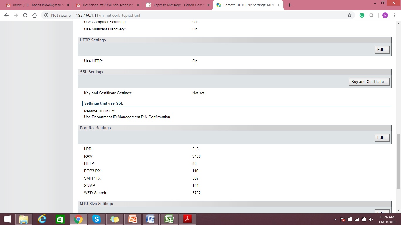

Hi Patrice,
I am using gmail. I tried to scan to email. I already set the the smtp port 465 and 587 still having issue. I already upgrade the firmware and driver on the printer. Attached is the information for your reference. I tried both port still have error. I tried all the possibilities. Need help so that i can configure and made these working.
