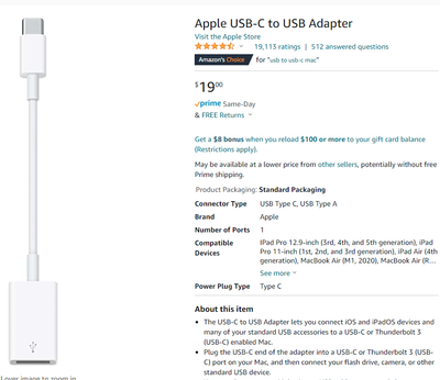

Greetings,
You are using the correct drivers for Catalina.
If you followed the install instructions and installed the drivers, waiting to be prompted to connect the printer, then it's the adapter you've chosen.
Try something like this.  Its probably a safe bet.
Hello Nadavidson,
You can check if the adapter that you have will work for the printer by checking in printers and scanners. In printers and scanners, you can click the + at the bottom of the list to see if the printer appears in the add printer window. If the printer does not appear in the add printer list while the printer is connected and turned on, it will mean the adapter is not working. The printer connection should appear in the list even if the drivers are not installed.
