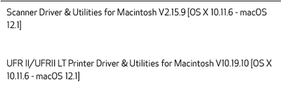

It's a MacBook Pro version 10.15.7. I have an adapter for the USB to my Mac. I downloaded the following:
I hope thats the right information you wanted.

You are using the correct drivers for Catalina.
If you followed the install instructions and installed the drivers, waiting to be prompted to connect the printer, then it's the adapter you've chosen.
Try something like this. Its probably a safe bet.
