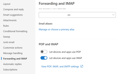

Once the POP Rx box is checked the 3 fields above become editable. You will need an incoming server address, username and password. I do not use iFAX, so have not tested it. I still have an analog phone line for my once a decade faxing needs. I see no reason why it wouldn't work as long as the mail provider supports POP. I might try imap to for good measure.
Example Gmail:
Example Outlook
Hope this helps.😃
Edit, forgot to add. When you enable pop or imap, both google and Microsoft provide the incoming mail server for you.
