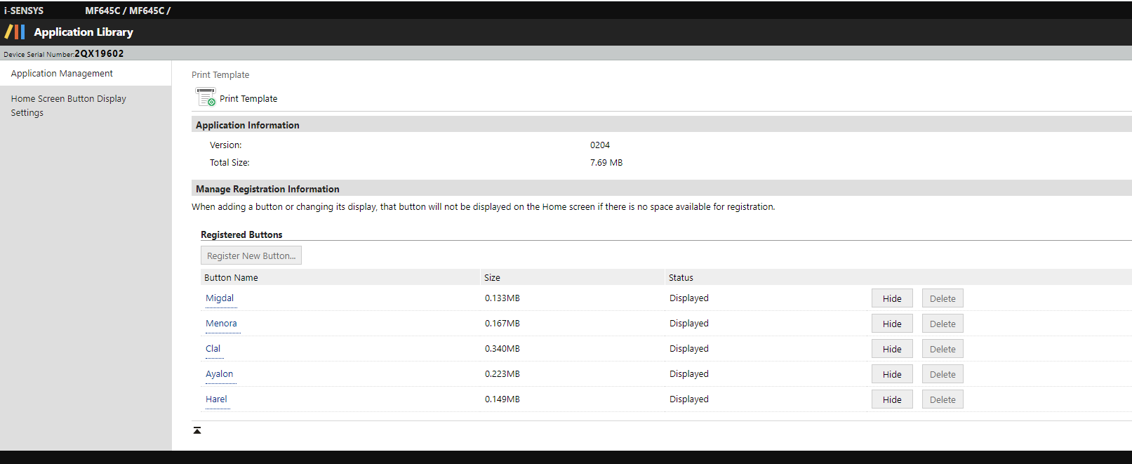

I would like to have about 8 files (pdfs) which i can print directly from the printer using the 'Print Templates' application.
I can only upload 5 templates altough the printer reports plenty of free space.
Is there a limit on the number of files or can i get around this? If there is a limit please can this get listed for a change at the next firmware update. cant see any reason to limit the number of files if there is memory available in the device...
Screenshot below, the [Resgiter New Button:] is now disabled after I added 5 pdfs
Thanks for any help

OK... so now officially strange.
I looked at the files, actually it can be seen from the screenshot.
The total storage of these five files is 884 KILObytes...
I would say well within the 48 MB limit !
so what's the deal here?

I have the same problem there apears to be a 5 button limit in templates and in the "Scan to Preset Destination"
Very disapointing.
