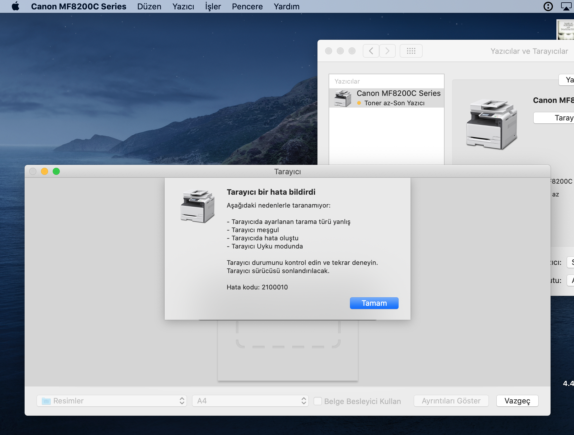

Occasional Contributor
Posts: 9
Registered: ‎12-21-2019
Re: MF8280CW WIRELESSLY PRINTING BUT NOT SCANNING
[ Edited ]
I am having the same problem with my MF8280cw printer using a MacBook 12 and OSX 10.15.2 Catalina I followed your posted instructions for adding the scanner with MF Toolbox- which worked only for adding the scanner. I am still able to print but not scan wirelessly.
Cannot scan because of the following:
- Scan type set on the scanner is incorrect
- Scanner is busy
- Error occurred in the scanner
- Scanner is in Sleep mode
Check the scanner status and try again.
Scanner driver will be terminated.
Error code: 2100010
Highlighted
