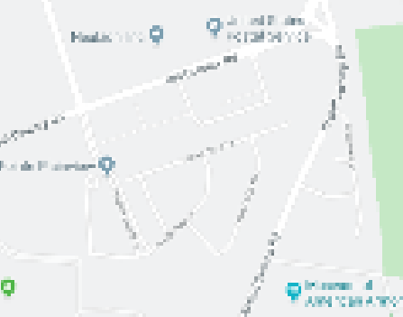

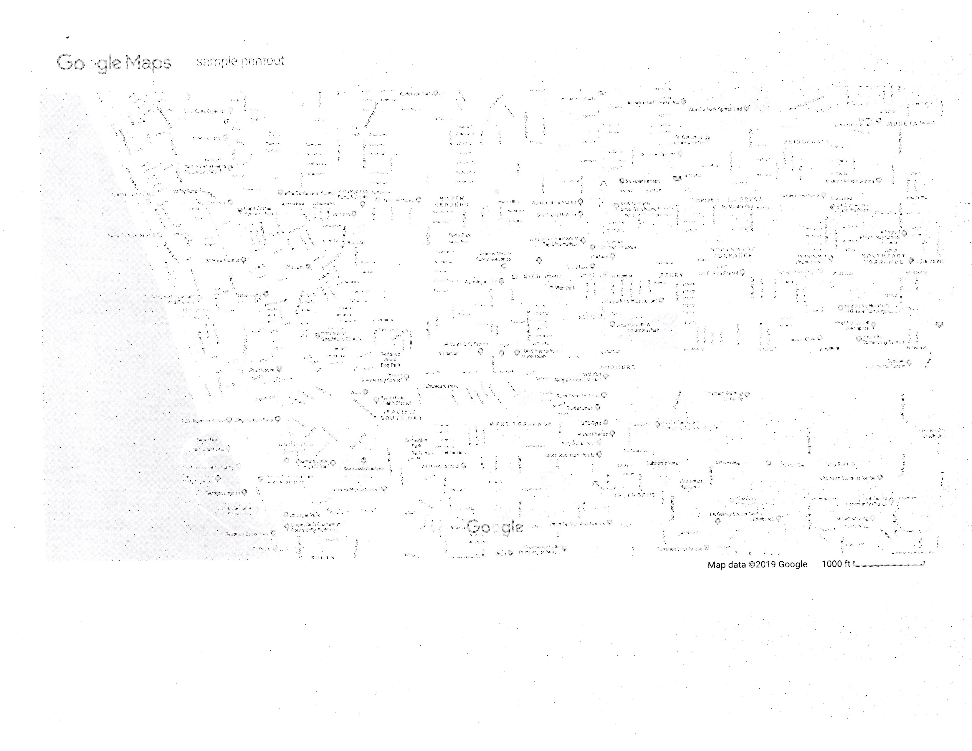

Can someone help me set this printer up such that it prints the maps well?
I got a CANON LBP6780DN. The printer is good. It prints everything except the google maps.
The maps printout is simply illegible.
It prints, you can tell that it printed a map, but somehow the letters within the map are not clear, can't read the names and can't figure the shape of the streets.
It always printed like this since I bought it new.
The bottom of the map has a sentence "Map data ©2019 500 ft " and that prints sharp and clear with no problems.
Thanks in advance for any helpful advice.

12-27-2019 01:43 PM
12-27-2019 01:46 PM
I attached a pic how it looks like.
I have no idea what you referred to.
Can you please walk me through?
I have 4 different browsers and all produce the same result.
The printer was set to 600 DPI and I am totaly surprised why it does what it does.
The map on the screen always looks perfect.
It's just the printout that sucks. Always.
12-27-2019 02:43 PM
Hi and23.
The original that you are trying to print is a color image, while the LBP6780dn is a black-and-white only printer. Even the text you see, that is not printing correctly, is a rendered image rather than text overlay. Try saving the original as grayscale or black and white, and then printing that gray/b&w image.

12-27-2019 04:07 PM - edited 12-27-2019 04:08 PM
Hello again and23.
The program/driver compensates the conversion from "color" to "black and white" by settting a threshhold below which color is set to black and above which it's set to white. Gray is produced as a speckled pattern of toner and no toner (to varying degrees, depending on how dark or light the gray is).
The font is both being squished down to fit the print area, as well as blurred (interpolated) with the surrounding colors, causing it to report as a "gray" area. Because the text is so small, the speckled pattern for the gray is making the text seem like every other dot is missing.
Since the LBP6780dn is only capable of printing the information sent to it by the computer, the most reliable way of correcting this problem is to save the image, convert it to grayscale or black and white, and then print. A black-and-white version of the original will show the same artifacting as the print. Either black and white or grayscale will allow you to adjust the contrast and levels to optimize the black and white image before printing.
