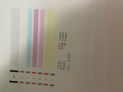

Here is an image from my print out. Would you still be able to assist? I need to be able to use this printer in my classroom!

Nozzle check test and a sample of the color profile it's printing everything in.  Both Canon and generic color cartridges, it makes no difference, same color profile.

Boiseboz, I assume yours is also a TR4720 printer. It appears that you have a bad color cartridge. I had the exact same nozzle check pattern with my MG3620, which printed everything with a red cast, and it was fine once I replaced the cartridge, which was half full at the time. You can run a deep clean. I can also suggest you clean the cartridge contacts inside the printer with a dry paper towel.  If nothing changes, that may verify that the cartridge is bad.
FYI A nozzle check bypasses your computer's print drivers and color profiles. Instead, it commands the printer to run an internal diagnostic test that forces the print head to eject pure, 100% saturated ink from every single nozzle. The goal is to print raw grids of black, cyan, magenta, and yellow to help you identify any clogged nozzles or missing lines.
That was my first thought was because it was a new generic cartridge, but then I put the previous cartridge back in as it had a tiny bit of ink in it and it did the same thing.  I'll order a new cartridge and run another deep clean (ran like 4 of those) and will clean the cartridge contacts as you suggested.

Yes it is, I totally understand, I had a cartridge misprinting, changed it and then it misprinted, both were remanufactured Canon cartridges. I replaced with a genuine Canon cartridge and that took care of the color problem.
