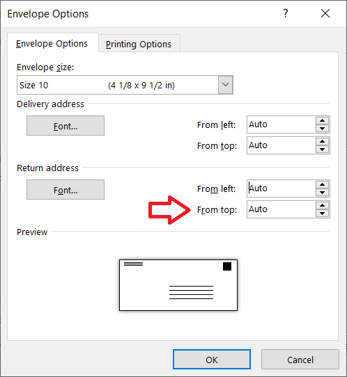

Greetings,
Word > Mailing menu > Envelopes
Then the Options button. Return Address section, from top... Remove "Auto" and use 0.25 or less.
Note: If you are using a non-standard custom font it might affect where printing begins.
01-07-2020 03:49 PM
Thank you, but it's not the return address (our envelopes are pre-printed). It's the delivery address. I've tried moving it and no luck.

Above in the thread, Shadowsports provided directions for reaching the Envelope Options in Microsoft Word. The screenshot included shows an Envelope size setting. Check that setting in your Microsoft Office software.

Even when I changed the location of the delivery address in the Word envelope options dialog box, it didn't make any difference.
