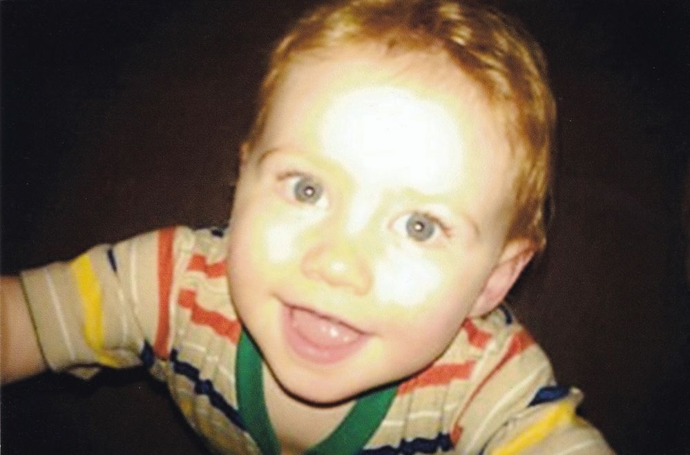

A 4"x6" photo is placed on the glass, using the exact same settings. TEST_0002A was scanned on our Canon C600(IP) using 600dpi, TEST_0002B was on the Maxify. Both were cropped and reduced since the output size is set to Letter (just in case) and due to the upload maximum here.TEST_0002ATEST_0002ATEST_0002BTEST_0002BSettings 1Settings 1Settings 2Settings 2

The sample images of the scans do not look like there is a hardware issue with the MB2720. The top image does look like it is scanning some of the grain in the plain paper print. If you are scanning photos and would like to adjust the color/intensity of the scans, you can use the scangear option from the IJ scan utility. You can view the color options for the MB2720 using the link HERE.
