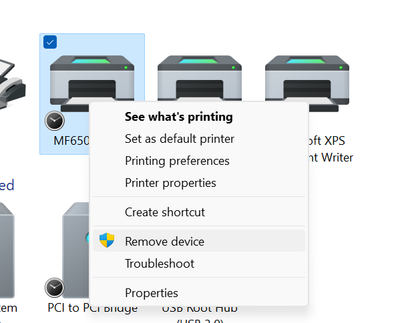

Remove the printer (all instances) from the Control Panel > Devices and Printers Applet . MB2720, MB2720 (FAX) etc. Use right-click, remove device from the context menu.

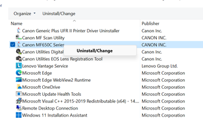

Once complete, return to Control Panel > Programs and Features
Uninstall all Canon Software related to the printer (one by one)
