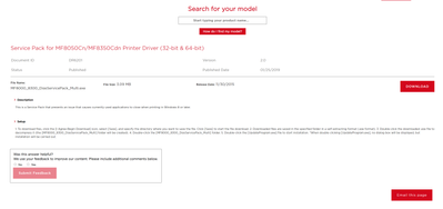

I may have found an answer on this page with this
https://canoncanada.custhelp.com/app/answers/answer_view/a_id/1010997/~/service-pack-for-mf8050cn%2F... Found on canada site.
09-17-2022 10:35 PM
Give it a try and post the results. 🙂
