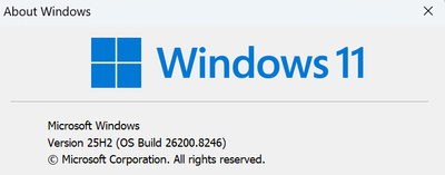

Re Windows version--

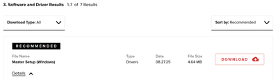

Re driver source--
Ran this download, selected UFR II, PCL6 & PS3 when prompted.

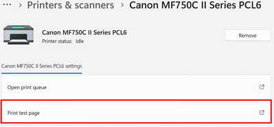

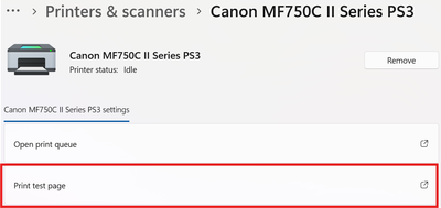

Re method to invoke printing PCL6 or PS3, in the simplest and most diagnostic case, clicking here in Windows Settings > Bluetooth & Devices > Printers & Scanners--
--and here--
Thanks!
