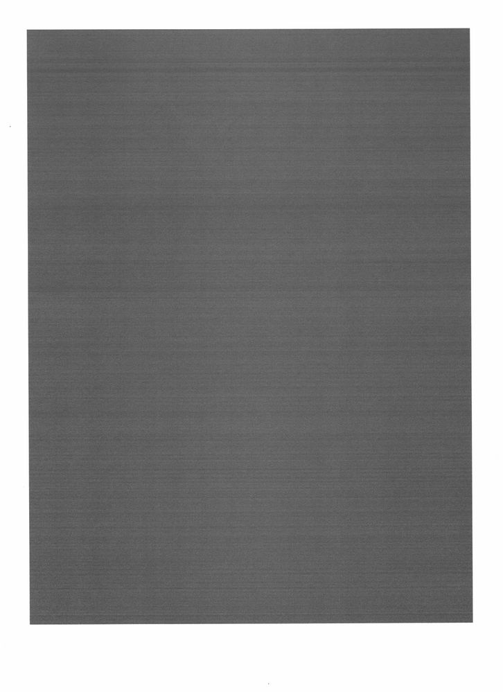

Hi guys, I got a brand new Canon monochrome laser MF269dw. Printing text, no problem with different fonts and sizes. When I print photos I notice there are horizontal streaks so I did more test. I printed some pure color page red/blue/yellow. Because this is a monochrome printer, it transfers them to gray pages. Then the streaks become very obvious, please see attached. So I was wondering what is the cause of this? Is there a way to fix this? Thanks for your help in advance.

I already tried those before I posted the question here:
Are you using appropriate paper? Yes, tried two different types of paper
Is the platen glass dirty? No
Have you cleaned the fixing unit? Yes, went through the cycle Are you using rough-surface paper? No
Are you using the machine in an environment with high humidity? No
Are you using paper containing much paper dust? No
Is the amount remaining in the toner cartridge running low? No, Brand new printer
Is the amount remaining in the drum cartridge running low? No, Brand new printer

Did you try the special processing settings linked from those options? Those will adjust how the printer applies toner to the page. Even if you don't believe that dust or humidty is affecting the printing, the special processing settings can improve output.

I had the same printing issue. However, it was resolved by replacing cartridges.
