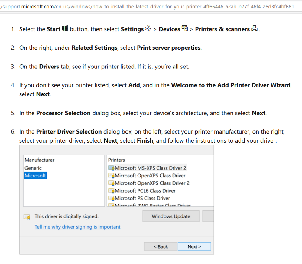

12-17-2020 02:49 AM
I know this is late for the OP, but in case it helps anyone else who finds this thread... I was just going through forums trying to find this same answer and here's what I found that WORKED for me:
https://support.microsoft.com/en-us/windows/how-to-install-the-latest-driver-for-your-printer-4ff664...
I followed the steps there, and at first I chose the printer that has (fax) next to it, but that one didn't work. So then I went in and chose the one that has the letters after it.... 'UFRII LT' and completed the rest of the steps and it worked!
I should mention that after chasing what the issue was for quite a while, I had also done the following:
1) Updated Windows
2) Updated just the "recommended driver" via the Canon site: https://www.usa.canon.com/internet/portal/us/home/support/details/printers/support-laser-printers-im...
2.a) I'm going to mention that I had to do this over again because it didn't work the first time, and I realized when I read the instructions that it's important to not have the USB for the printer hooked to your computer when you install the drivers. The first time I tried, the USB was plugged in, and I had to go through and uninstall and remove the printer and it took a while. Second time I tried, I did it with the USB disconnected, and it was a breeze. It worked correctly.
3) Restarted my computer
4) Followed the simple instructions on the link provided above. I'll include a screenshot below of the instructions in case that link ever doesn't work in the future.
5) Also worth mentioning that when I tried to "add a printer" on my computer, I had to choose the last option "install manually" (or something like that) because the computer still wasn't recognizing the printer was connected. Then I had to choose "USB001" as the port, not the "LPT1" since LPT1 is for an older kind of cable and my computer uses a USB to connect to the printer. ***
6) Made this printer my default printer, and had to scroll over in the printing screen to find it and make sure it was selected and it worked... and it did work! It's printing now.
This was not easy to figure out, but seems really simple after the fact. I just wanted to post what actually FIXED it for me, in case it can help anyone else in the future.

12-17-2020 02:49 AM
1) Updated Windows
