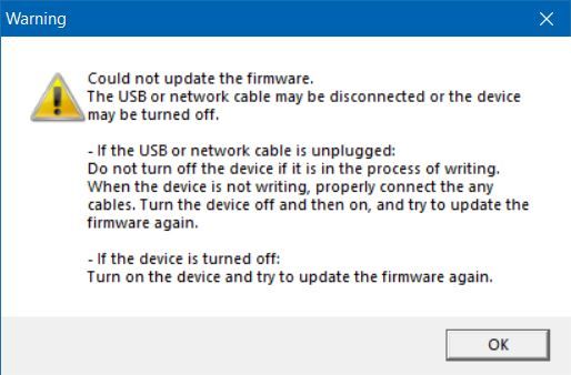

I have been trying to update the firmware on my Canon Color imageCLASS #MF753Cdw, but keep getting an error
I am using the MF753Cdw/ MF751Cdw Firmware Update Tool V03.04 [Windows], dated 09/01/2023 from the Canon website. The filename is "win-mf754-751-fw-v0304.exe". It won't update from the Printer's Firmware update menu option. I have tried running this from my desktop, from a laptop (connected via WiFi and Ethernet), and via a USB cable directly to the printer. The WiFi and Ethernet options cannot find the printer and I have to enter the IP address and the USB cable cannot find the printer, as well. The Support notice states "Vulnerabilities of network accessible products have been addressed." So, I thought it would be important to update my printer.
When I tried updating via a USB cable, I used the USB-A port on the back of the printer, as opposed to the USB-B port. Would this make a difference? (I don't have a USB-B cables anymore, which is why I used the USB-A port). Thanks for your help.

01-06-2024 09:17 PM
I had same issue with a 652 that I just bought. Turns out, during set up, I entered 2023 as the current year (it is Jan 6, 2024 as I type this). Fixed the date to be 2024, and it updated with no problem.

12-20-2024 11:09 AM
Hello,
To perform the firmware update via USB, you would need to connect the printer to your computer with a standard A to B USB cable. To contact support for the MF753Cdw, you can call support over the phone at 1-800-652-2666. Our agents would be happy to check what might be causing the firmware update issue and walk you through the process.
