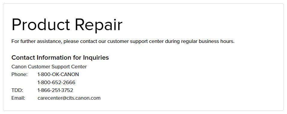

theroots
I tried contacting Canon Support via the email address listed on my Account for my printer, but the email bounced saying the email address was unmonitored.  Alternately, it said to contact support through the Chat, which it said was available 9:00 am through 9:00 pm.  But the Chat button, hasn't been available all day.  My printer is still under warranty, so Canon, how do I get support other than calling?

Hello,
To perform the firmware update via USB, you would need to connect the printer to your computer with a standard A to B USB cable. To contact support for the MF753Cdw, you can call support over the phone at 1-800-652-2666. Our agents would be happy to check what might be causing the firmware update issue and walk you through the process.
