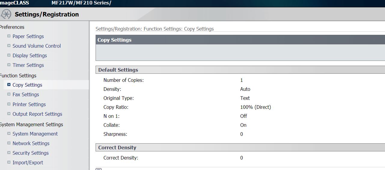

Thanks for the reply.
I checked the Copy settings, and the [N on 1] function is OFF. I turned it ON, then OFF again to see if it resets, but still getting the same issue.

Collate features shoud be off. <Copy> <Collate> <OFF>
Copy Ratio should be %100.

I tried all the above and checked the guides, nothing seem to make a difference so far !
