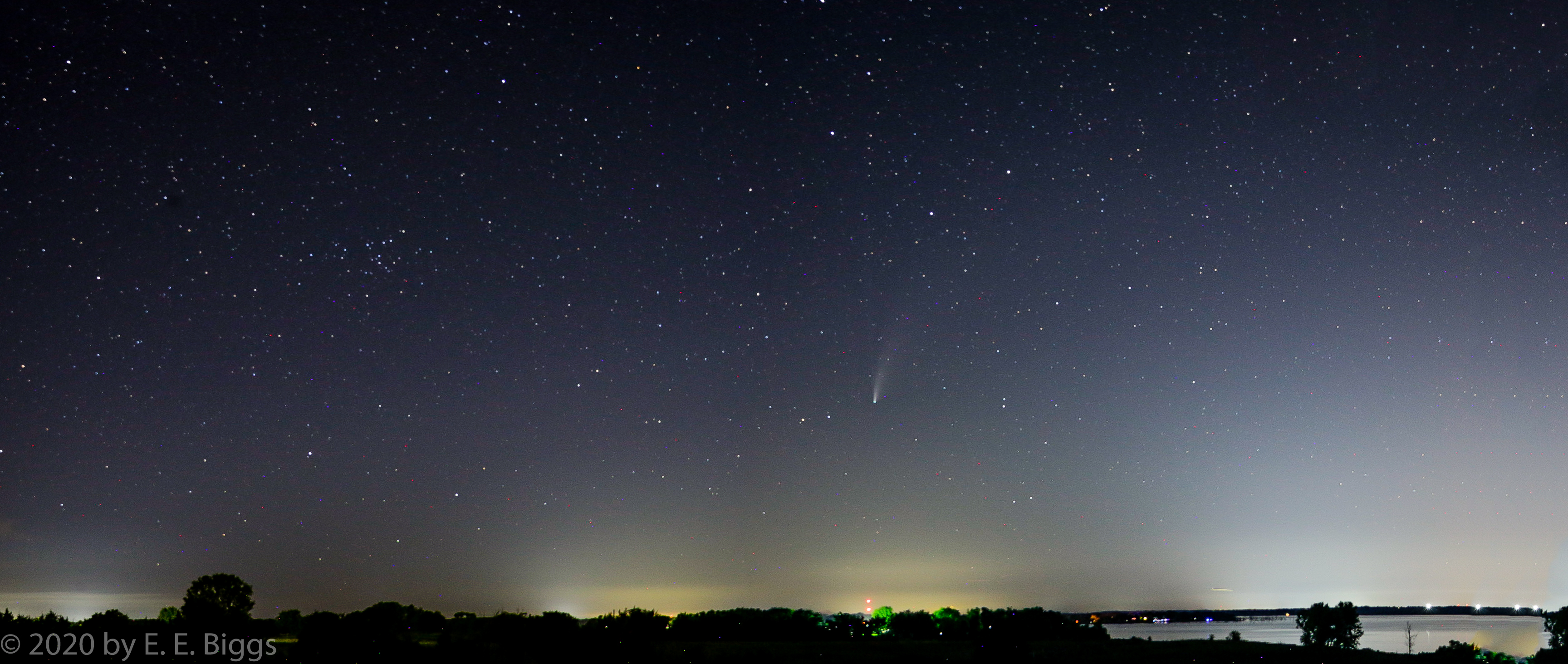

Down at Hillsdale Lake, Neowise was clearly visible in the dark skies.
