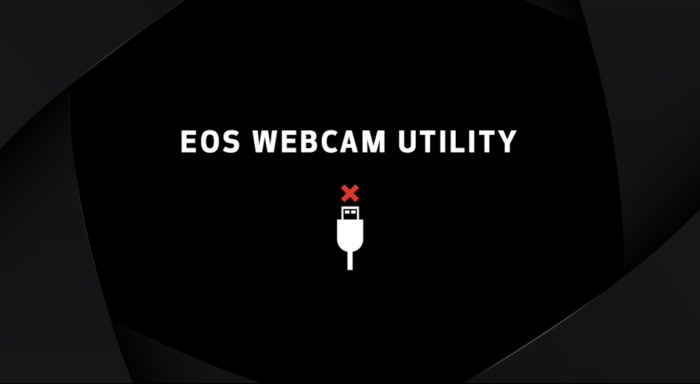

Now in Aug2024 out of nowhere what is happening is:
- the camera is rightfully recognised when I open EOS Utility.
- I quit it so it doesn't clash with the other app such as Zoom etc
- when I open Zoom etc it gives me now permanently this screen (which is different from the screen I used to have in may 2024 or whenever it wouldn't recognise the camera due to a bad cable or such, which is this screen with a red x on a cable, meaning I didn't find a camera connected to the mac). So it's worse because now even if the cable isn't even connected, the screen remains the same, and the video just doesn't load or start
PLEASE HELP
