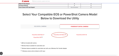

02-21-2024 10:20 PM
I have the PowerShot G7x mark iii which is listed as compatible
02-21-2024 10:50 PM
“ I'm trying to use my Canon g7x as a webcam for podcast recording. The camera is working as a webcam via USB but I'd like to adjust the resolution in the EOS Webcam Utility window. “
The G7x mark III is supported, but the much older G7x is not.
What resolution is the output when you report that it is working? What is the resolution that you are looking for the camera to provide?
I believe that most cameras will produce Full HD output. Many of the entry and beginner level cameras only provide lower resolutions.. No camera is capable of provide it output resolutions higher than what it can record in video mode.
Contact Canon Support for the supported output resolutions for this camera model.
