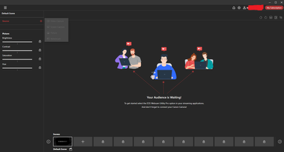

Another thing to check with this issue would be to see if the EOS Webcam Utility software itself is picking up your camera. The webcam screenshot in your most recent post is what is shown if the streaming or webcam service you are trying to use isn't getting the feed. If you open the EOS Webcam Utility software directly it will have a window with Scenes at the bottom. If the EOS Webcam Utility itself is detecting the camera the video feed should be shown as one of the scenes. Checking that would help narrow down where the disconnect is happening.
06-15-2024 03:02 PM
This is what i see in EOS webcam Utility
