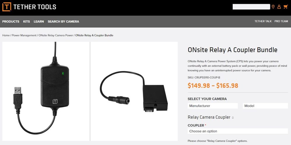

Thanks for your thoughts.
The on Site Tether tools is a dummy battery pack connected to a conditioning relay that lifts the voltage to suit the camera. The relay contain an internal battery which is charged from an external source. The company claims indefinite supply to power the camera. [Commercial link removed. Replaced with screenshot to facilitate discussion.]

"It still sounds like you are powering the camera from a USB port. A USB port does not have sufficient output to power a DSLR."
I am in agreement with this. You are still at the mercy of the power output of the USB port on the computer. I think most USB ports are 5 volts and the 70D needs 7 volts. Anyway this may give you something to think abbot and how to maybe fix your rig since I have not tried to do it.

@redged01 wrote:Thanks for your thoughts.
It sounds like it does not work as claimed. This is a Tether Tools issue. I doubt if it will ever work indefinitely. You seem to have proven that to be a fact.

Hi,
The Tether relay is powered directly from a 5V 3A USB charger. In the Relay there is a battery to just an uninterrupted power supply. From that battery there will be a boost converter to lift the voltage to 7.1V needed for the camera. This tether connected directly to the battery terminal and is not a USB tether in the usual sense. I do believe that it is the Tether system, and I would recommend caution using the system. There may be a way around it by allowing the camera to go sleep mode and use a relay to trigger the shutter rather than a software signal from gphoto2. I'll let you know.

I also recommend using the Canon battery eliminator gear. The battery in your current setup is running out of power.
