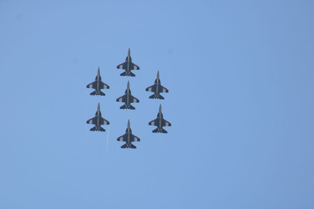

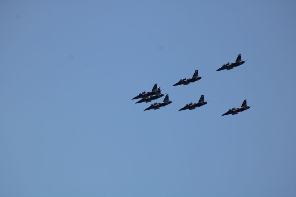

I had a Canon Rebel camera that kept producing weird dots in photos so I purchased an EOS 2000D. I am having the same exact issue with this camera. Recently went to an air show and took 659 pictures with 2 different lenses. Dots appear in all 659 pictures in the same position. Since I used 2 different lenses, there has to be an issue in the body of the camera. When I remove the lens, I do not see any debris on the mirror. I try to keep the camera at a constant temperature to avoid any condensation. Any ideas as how to correct this issue? I saw the same dots in another post and they were in the same position as well.

Please post an image so we can see your "dots" 🙂
"When I remove the lens, I do not see any debris on the mirror."
Debris on your mirror will not show on your images. It is flipped up and out of the way when you take the shot to allow light (image) to be captured by the cameras sensor.
It does seem odd that two cameras have the same issue, but I quit trying to rationalize things a long time ago... Still, my thought is sensor dust. But not knowing how often or what care you take when changing lenses, it's just a guess.
Newton

07-09-2026 01:14 PM
Upper left then above 1st left plane then above 1st right plane

07-09-2026 04:04 PM
Thanks for the images, VideoMaster!
To me, it does look like something on your sensor. My cameras get "stubborn" dust on their sensors every now and then that the built-in auto clean feature won't remove. I start with a Giotto Rocket blower, which works most of the time. If that fails, I use a sensor brush. Sensor brushes carry a light static charge created when the bristles rub together (lightly tapping it on your finger recharges it), they are also great for lenses. If it's really stubborn, I use a dry sensor swab but have used the liquid sensor cleaner that came with my sensor swabs. If you are squeamish about taking this on, by all means, take it to a pro.
**If you do give it a go on your own, follow the instructions that come with your cleaning gear**
Newton
