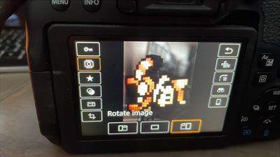

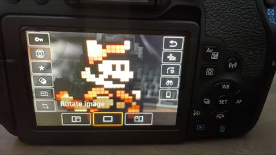

I'm not a camera tech, but I used to be.
Go into review mode (press the blue playback arrow).
Go to your image that is rotated incorrectly.
Press the [Q] button
(this might be different - I'm looking at my Rebel T7i)
You should see a button that looks like stacked photos and a rotate arrow (on mine it's under the key icon - second one on the left) - you'll see "Rotate Image" on the bottom of the screen:
Along the bottom, either tap one of the buttons to rotate the image, or use your arrows next to the "SET" button to select one of them:
And that's that!
