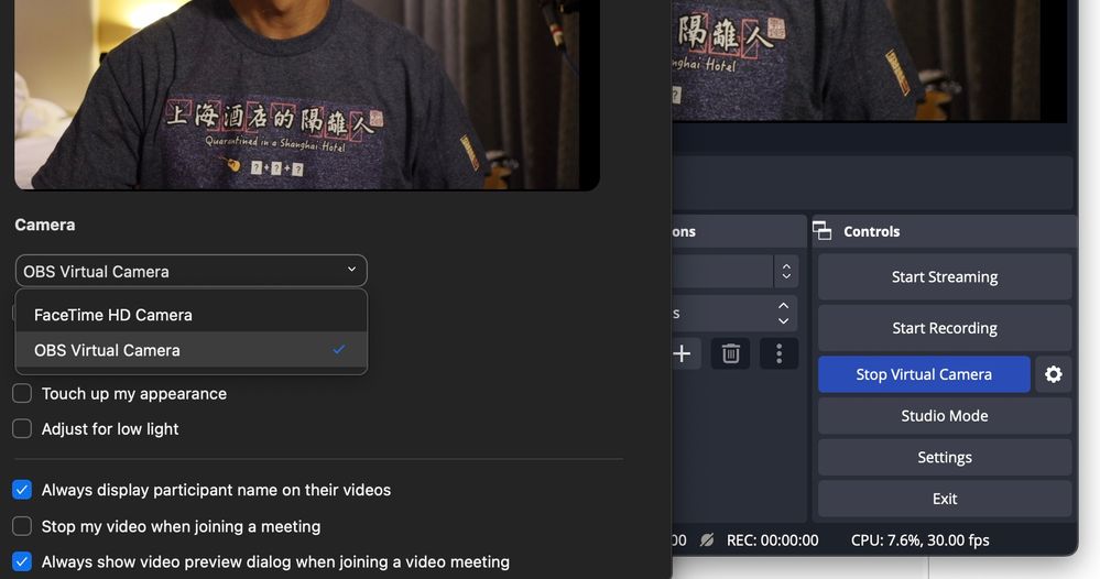

Try the following: Download and install the free streaming software OBS on your Apple Silicon Chip Mac.  Start OBS and select the EOS Webcam Utility as a camera (you will need to shutdown EOS Utility 3 first).  Click "Start Virtual Camera" in OBS.  Launch Zoom, and you will be able to select OBS Virtual Camera as a video source.  Good luck!
Here is a sample screen shot with OBS in the background and Zoom in the front.
