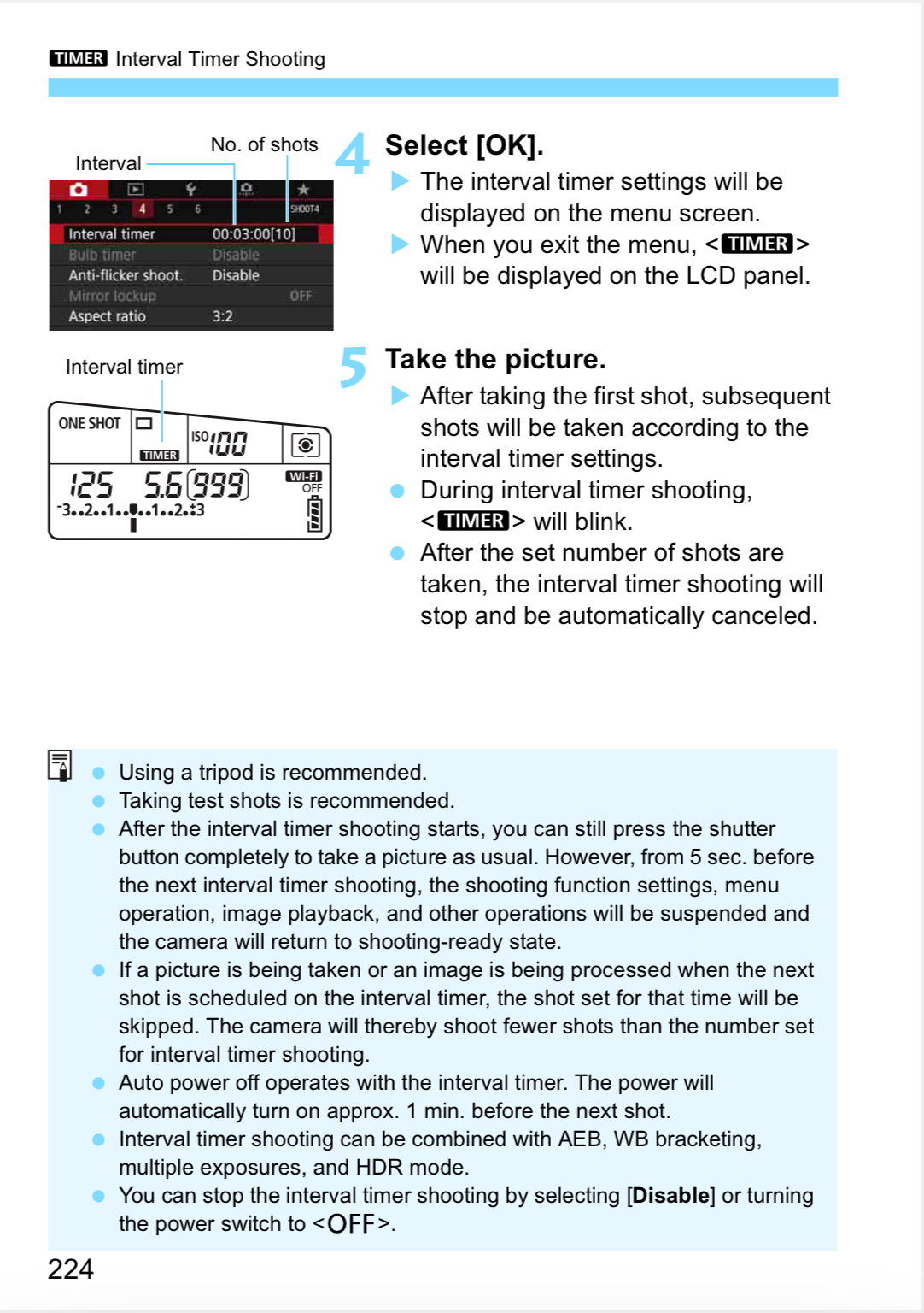

According to the full User Manual, the top display is supposed to blink "TIMER" when it is running.
What makes you think that it stopped? OBviously, did it stop capturing images? You were only capturing about three per hour, so the NR reduction settings should not have been a factor. But, I would turn all of the off, anyway.
Does the camera turn itself off between shots? The User Manual seems to suggest that it should.

You can check the images between shots. In fact, according to my screen shot above, the camera can capture stills just by pressing the shutter. I see no reason why you cannot browse images just as you would browse the menu systems.
The moment you turned it off is when you lost any chance to see what the camera was doing. A power cycle resets it all.
