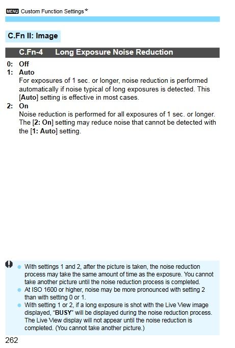

Does it happen after you take an image?
It could be taking a "dark frame"

It does happen after taking a picture, but it is not a dark frame. I can hear the camera when it releases after the picture is taken/completed. If in live mode at the time, I can still see the image that I am taking a picture of, but it does not let me back out of it to the main screen to change settings and doesn’t not do anything when pushing the other buttons (except the shutter to take another picture). If it’s not in live mode and freezes while I’m on the main screen with the settings displayed, it will do the same- not do anything no matter the button I push.
