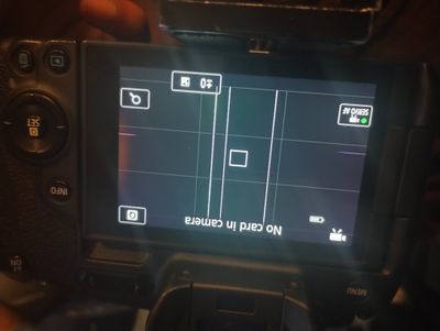

I was shooting a night club and it had rays of lights coming in. I was shooting a video. First ten seconds the sensor had no stripes or issues. But after 10 seconds it had one stripes then the second one then the third. Did anyone had the same problem or can I actually get a help?
I have a real footage of the sensor starting to have the stripes. Any help would be appreciated. Thankyou

The photo does not look good.  What type of lighting was in the club?  Was there a laser show?
It does look like the damage caused by a laser.

I do agree with you and @Waddizzle this looks like damaged caused by some sort of laser. The OP said "I was shooting a night club and it had rays of lights coming in".

Unlikely laser damage would be perfectly vertical lines.
That was my initial thought, but I Googled it and lots of images of straight line laser damage.
I agree.  Any laser that can cause that type of damage to a camera is strong enough to blind someone if it hit their face.
