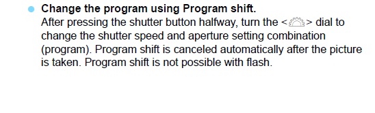

jmquig:
Did you know about this:
It works in P mode. It keeps the exposure the same. Of course, it never seems to go in the direction I want, but it is worth a try. 8^)
