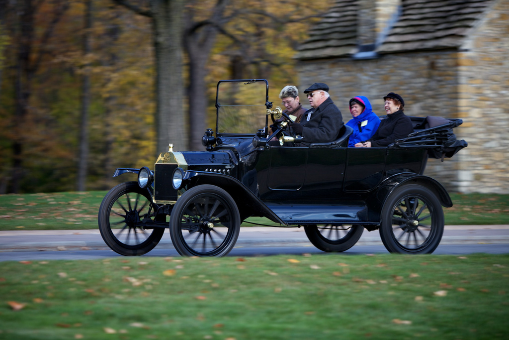

You can take this in stages.   Initially what you want is a clean sharp shot.  Ultimately it's the car that you want sharp.
When you are shooting action, a shutter speed of about 1/500th or faster will usuaully freeze most action.  Particularly fast action may need faster speeds (1/1000th or faster) and some action can be frozen using shutter speeds as slow as 1/250th.
With your lens fully zoomed in, the widest aperture you can use is f/5.6 -- thats the lowest aperture that can be used at all focal lengths.  Your lens can go down to f/3.5 but only on it's wide-angle (short focal length) end (and on 7D, 28mm will not be "wide" but it would be on a full-frame camera.)
The one downside of doing a great job of freezing action, is that the shot ends up looking like you photographed a car that was just sitting still.  It wont appear to be a moving car.  To "imply" the motion in the image, the shutter speed has to slow down.  Ordinarily a camera would remain still while it takes the shot, but if you do this, you get a background that has no motion blur -- and a moving subject that is blurred -- not what you want.  BUT... if the camera tracks the subject as it moves, the subject will appear sharp and the BACKGROUND will appear blurred.  Also... the wheels will appear blurred because they are twisting as the shot is taken.  This creates an effect that looks more like these:

Incidentally... when I take these panning shots, I set the camera to contninuous shooting mode so I'm actually shooting many frames.  You'll find that some frames look better than others and you can pick from among your favorites.
Like anything ... it takes some practice but it's not too difficult and you'll soon get the feel for making the smooth sweeping motion as you shoot.
