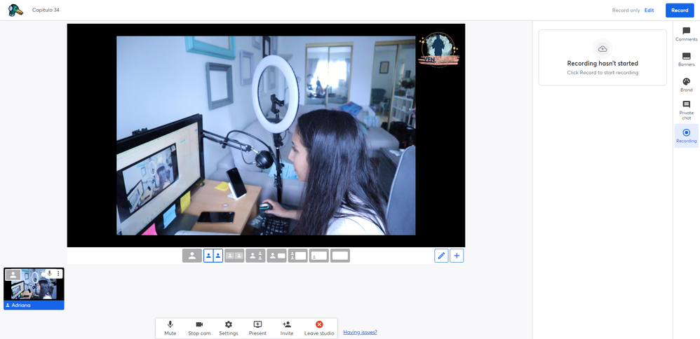

Hey, I don't know what setting I changed that now my video is too small when streaming. The canvas is bigger than the video itself. I tried with different platforms and it's always the same, which means it is a camera setting. Do you know what I am doing wrong? Here is an image. Look how much black space I have! Thank you in advance. canon.png

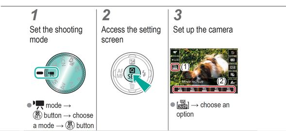

Also, check the movie recording size:

In the image you posted, the frame of the video content is at a 3:2 ratio. The standard ratio you'll want to use for HD or UHD footage would be 16:9 which would lead to having more content along the right and left edges. I've outlined that ratio's area using red:
16:9 framing
