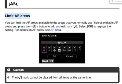

FloridaDrafter
Check that it's not turned off. Press the MENU button and look in AF > Page 4 > Limit AF areas.

FloridaDrafter
Newton
that did it. thank you.
