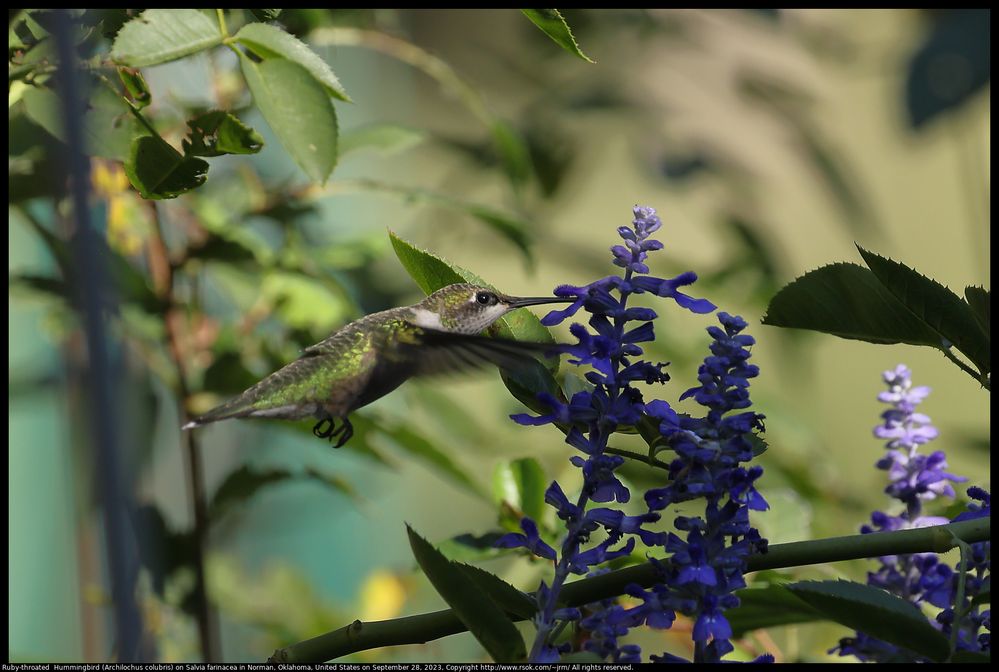

If I start with the focus distance near the distance of the hummingbird or other bird, then I find that the EOS R5 will often focus on the eye of the bird when eye detection is enabled. To get the focus to nearly the right distance, I auto focus first on something high contrast at near the same distance as the bird, or turn the focus ring on the lens to get close. For birds with wings moving rapidly, I sometimes hold down the shutter button and keep the photo that has the wings in the position that pleases me most. I do not put out a humming bird feeder, but try to have some flowers in pots near a chair I sit in outside my house.
I also miss many shots. I am old and slow. But I am getting better with practice.
Ruby-throated Hummingbird (Archilochus colubris) in Norman, Oklahoma, United States, July 22, 2023. The bird was partially obscured by out of focus foliage, but the eye detection on the EOS R5 managed to find the eye.
Ruby-throated Hummingbird (Archilochus colubris) on Salvia farinacea in Norman, Oklahoma, United States, September 28, 2023. The humming bird was going from sunlight to shade to sunlight, but the EOS R5 eye detection managed to find the eye. The wings are blurry from motion, but the eye is not because the bird had stopped at a flower. I held down the shutter button and kept the best photo.
