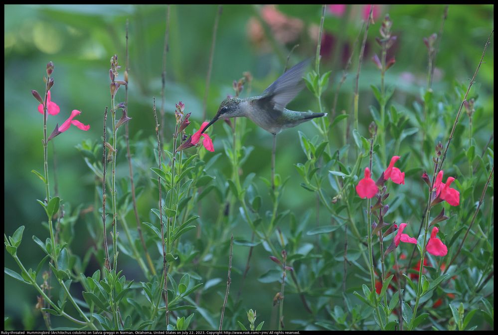

I also have an EOS R5 and I use tracking and eye focus. I hope some of this might be helpful. I usually autofocus on a flower at about the same distance as the bird and then focus on the bird.
Ruby-throated Hummingbird (Archilochus colubris) on Salvia greggii in Norman, Oklahoma, United States, July 22, 2023Ruby-throated Hummingbird (Archilochus colubris) on Salvia greggii in Norman, Oklahoma, United States, July 22, 2023
The above photo is at https://www.rsok.com/~jrm/2023Jul23_birds_and_cats/2023jul22_hummingbird_IMG_4930c.html  and was made with these settings as reported by exiftool:
EXIF:Image ExposureTime 1/500
EXIF:Image FNumber 6.3
EXIF:Image ISO 2000
MakerNotes:Camera ContinuousDrive Continuous, High+
MakerNotes:Camera FocusMode AI Servo AF
MakerNotes:Camera CameraISO Auto
MakerNotes:Camera MeteringMode Evaluative
MakerNotes:Camera FocusRange Auto
MakerNotes:Camera CanonExposureMode Flexible-priority AE
MakerNotes:Camera ImageStabilization On (2) (mode 3)
MakerNotes:Camera SafetyShift Disable
MakerNotes:Camera DigitalLensOptimizer Standard
MakerNotes:Camera PeripheralLightingSetting Off
MakerNotes:Camera DistortionCorrectionSetting Off
MakerNotes:Camera AFConfigTool Case 1
MakerNotes:Camera AFTrackingSensitivity 0
MakerNotes:Camera AFAccelDecelTracking 0
MakerNotes:Camera AFPointSwitching -1
MakerNotes:Camera AIServoFirstImage Equal Priority
MakerNotes:Camera AIServoSecondImage Equal Priority
MakerNotes:Camera OneShotAFRelease Focus Priority
MakerNotes:Camera AutoAFPointSelEOSiTRAF Enable
MakerNotes:Camera LensDriveWhenAFImpossible Continue Focus Search
MakerNotes:Camera SelectAFAreaSelectionMode Single-point AF, Auto, Zone AF, AF Point Expansion (4 point), Spot AF, AF Point Expansion (8 point), [6], [8], [9], [10], [11], [12], [13], [14]
MakerNotes:Camera AFPointDisplayDuringFocus Selected (constant)
MakerNotes:Camera SubjectToDetect Animals
MakerNotes:Camera EyeDetection On
MakerNotes:Camera RollAngle -0.7
MakerNotes:Camera PitchAngle -3.4
MakerNotes:Camera FocalLength 300 mm
MakerNotes:Image FocusDistanceUpper 3.68 m
MakerNotes:Image FocusDistanceLower 3.35 m
MakerNotes:Image ShutterMode Electronic First Curtain
MakerNotes:Time TimeZoneCity Chicago
MakerNotes:Time DaylightSavings On
MakerNotes:Time TimeStamp 2023:07:22 08:56:38.15
Composite:Camera LensID Canon EF 100-400mm f/4.5-5.6L IS II USM
Since you wrote that you only wanted responses from those who had photographed hummingbirds, these are most of the hummingbird photos that I have put on my web server. I have become more skilled as time has passed.

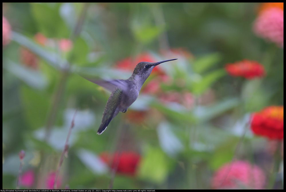

If I start with the focus distance near the distance of the hummingbird or other bird, then I find that the EOS R5 will often focus on the eye of the bird when eye detection is enabled. To get the focus to nearly the right distance, I auto focus first on something high contrast at near the same distance as the bird, or turn the focus ring on the lens to get close. For birds with wings moving rapidly, I sometimes hold down the shutter button and keep the photo that has the wings in the position that pleases me most. I do not put out a humming bird feeder, but try to have some flowers in pots near a chair I sit in outside my house.
I also miss many shots. I am old and slow. But I am getting better with practice.
Ruby-throated Hummingbird (Archilochus colubris) in Norman, Oklahoma, United States, July 22, 2023. The bird was partially obscured by out of focus foliage, but the eye detection on the EOS R5 managed to find the eye.Ruby-throated Hummingbird (Archilochus colubris) in Norman, Oklahoma, United States, July 22, 2023. The bird was partially obscured by out of focus foliage, but the eye detection on the EOS R5 managed to find the eye.Ruby-throated Hummingbird (Archilochus colubris) on Salvia farinacea in Norman, Oklahoma, United States, September 28, 2023. The humming bird was going from sunlight to shade to sunlight, but the EOS R5 eye detection managed to find the eye. The wings are blurry from motion, but the eye is not because the bird had stopped at a flower. I held down the shutter button and kept the best photo.Ruby-throated Hummingbird (Archilochus colubris) on Salvia farinacea in Norman, Oklahoma, United States, September 28, 2023. The humming bird was going from sunlight to shade to sunlight, but the EOS R5 eye detection managed to find the eye. The wings are blurry from motion, but the eye is not because the bird had stopped at a flower. I held down the shutter button and kept the best photo.

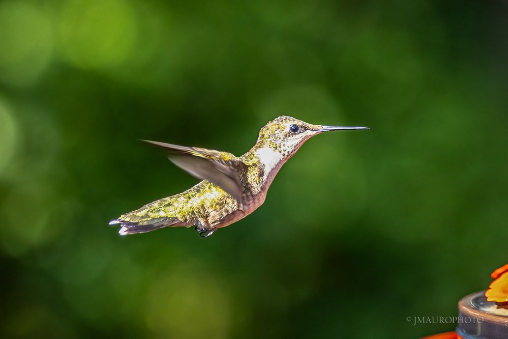

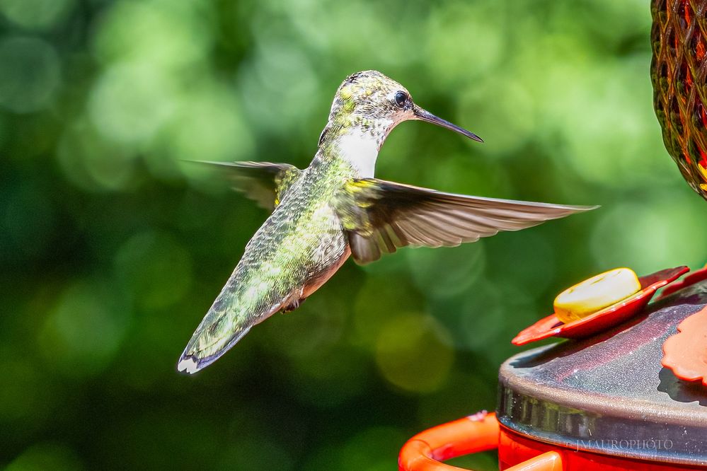

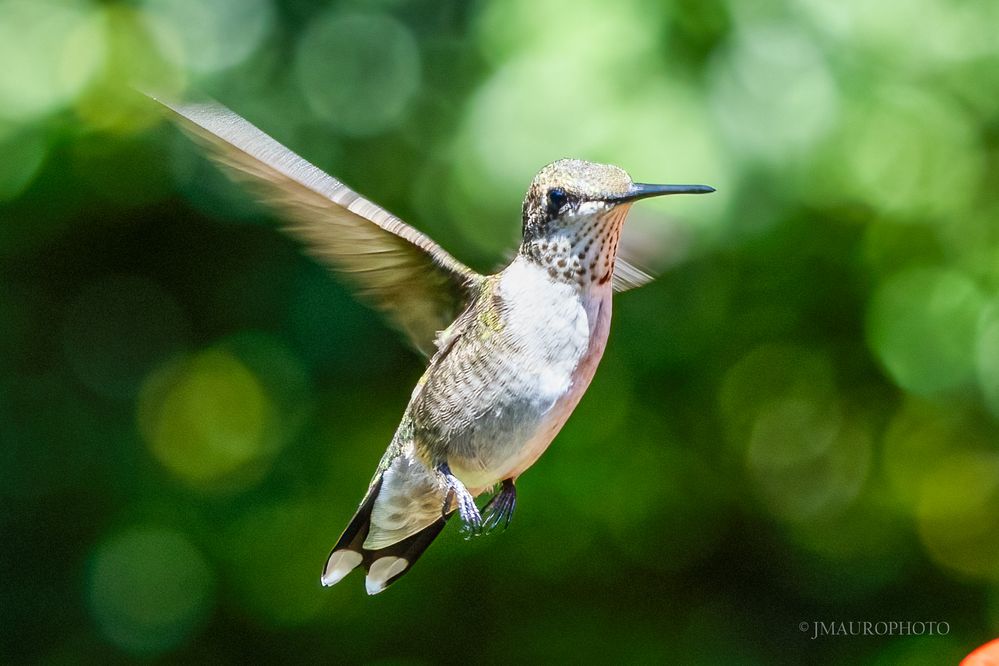

Good luck with that. I have a feeder hanging off my deck. I capture them at or as they approach the feeder. The approach is more-or-less "in-flight," so what you might consider is caching them at about the feeder, and then removing the feeder from your photo with PS. I have tried Av with the flash at sync speed (1/200) and have gotten pretty decent results, but even at that, there is no way to "stop" the wings. Right now I am trying Tv set to 1/1600, f/5.6 and ISO 800, with the flash set to ETTL/HSS, and also without the flash. The flash EX600II-RT helps stop the wings. The feeder is in bright sunlight. I am using an EOS R5 with RF 70-200 f/2.8 and triggering it remotely with an RF remote trigger. So far it looks like I have gotten a few decent shots. It takes a lot of patience. There was a ruby throated HB flying around but this one kept chasing him away :-).
All processed in Lightroom and noise reduced with Topaz AI. The camera was set to AF on animal's eye. For the most part it worked very well.
ISO800, f/2.8, 1/1600, 89mm Flash did fire
ISO1000, f/6.3, 1/800, 100mm, Flash did not fire
ISO 1000, f/6.3, 100mm, 1/800, Flash did not fire
