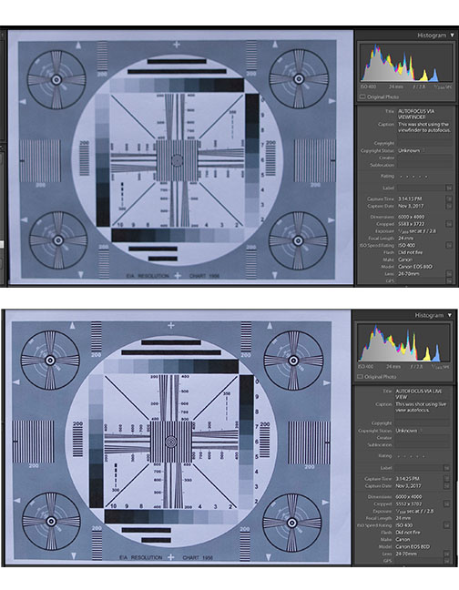

I have a brand new 80D and I have the same viewfinder vs. live view focus problem.  I think it's the camera.  These images were shot using a tripod and timed (2 s) shutter release.  My hands did not touch the camera when the pictures were taken.
One shot, single, center point autofocus, 24mm, iso 400, f 2.8. It's a little hard to see, but the top image was autofocused through the viewfinder. The bottom image using live view.  My old Rebel T1i takes better pics. Guess I have to send the camera in for warrenty repair.  Very disappointing, brand new $1100 camera.Compare.jpg
KevinG1
Enthusiast
Its not the camera. Read the post. It has to do with using the 45pt autofocus
