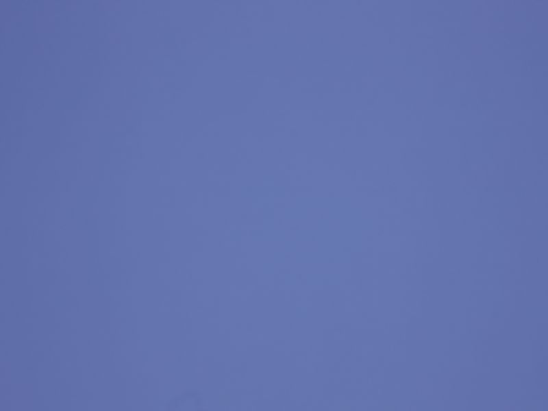

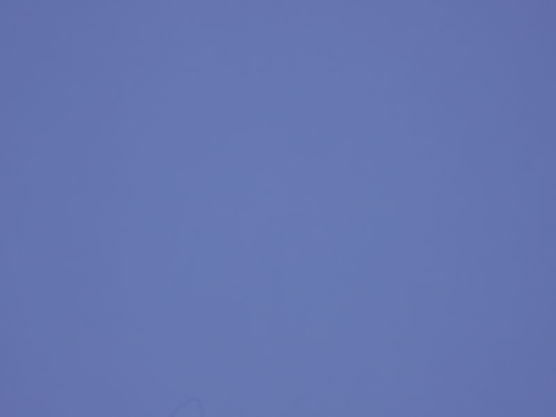

I've been taking a series of white paper photos to test for scratches or dust. I just received my refurbished camera last week. f/1.4 - not visiblef/1.4 - not visibleAround f/12 - visibleAround f/12 - visiblef/22 - highly visiblef/22 - highly visibleAs the f stop progresses, a pretty clear black shape appears in the bottom left of my photos. I can't tell if this is on my lens or on the sensor.
1)First shot is 1.4
2) Second is between f/12-16 (can't remember)
3)third shot f/22
I only have one lens right now so I can't switch them out to check. I want to send it back if it came this way.
Can anyone please help?

My bad eyes cannot see anything.  Could draw a circle around the spot?
Hi Waddizzle,
Here is the f/22 photo.  Untitled design (3).jpg
Peter
Seems like hair on the sensor.

Hi Rick,
I purchased this directly from Canon’s website. I was bummed when I took off the sensor cap for the first time and noticed a dust layer, and what looked like a tiny curved scratch on the filter, and a tiny finger swipe of some sort. The swiped area looks dustless, leaving the remaining area looking like there’s a film.
I did take an unboxing video showing it. I wasn’t sure if this was acceptable as a refurbished camera and took some photos to test. I am going to send it back for cleaning.
Thank you for your input,
-N
Now that the OP has circled it I agree it is either a hair on the sensor or in the mirror box.
