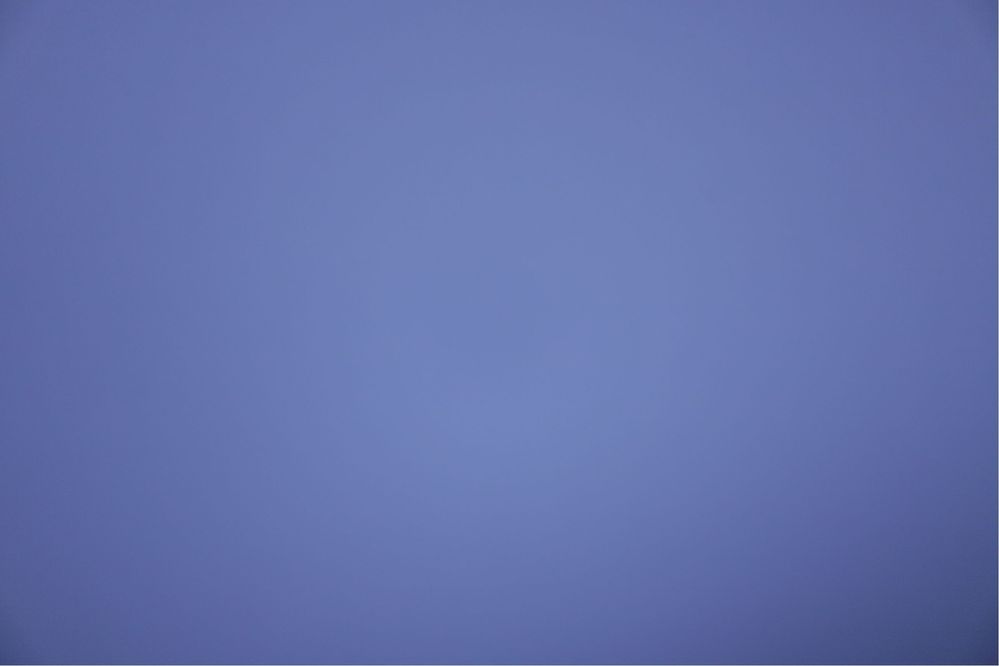

I've been taking a series of white paper photos to test for scratches or dust. I just received my refurbished camera last week. f/1.4 - not visible
Around f/12 - visible
f/22 - highly visibleAs the f stop progresses, a pretty clear black shape appears in the bottom left of my photos. I can't tell if this is on my lens or on the sensor.
1)First shot is 1.4
2) Second is between f/12-16 (can't remember)
3)third shot f/22
I only have one lens right now so I can't switch them out to check. I want to send it back if it came this way.
Can anyone please help?
Thank you!

My bad eyes cannot see anything. Could draw a circle around the spot?
12-06-2023 12:56 AM
Hi Waddizzle,
Here is the f/22 photo.
12-06-2023 01:30 AM
Seems like hair on the sensor.

Now that the OP has circled it I agree it is either a hair on the sensor or in the mirror box.
