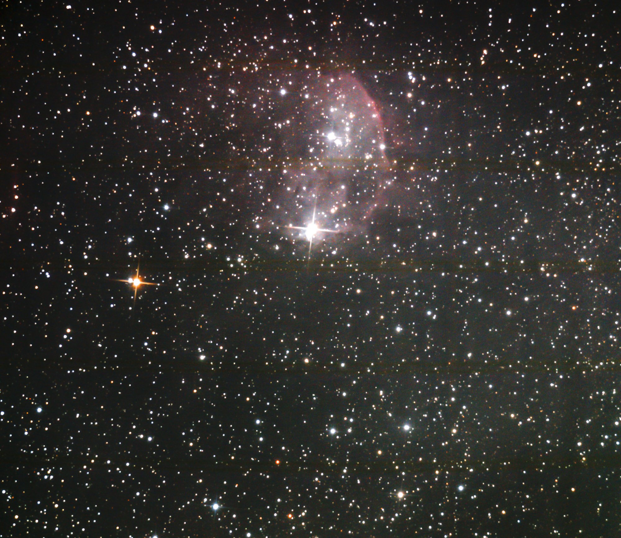

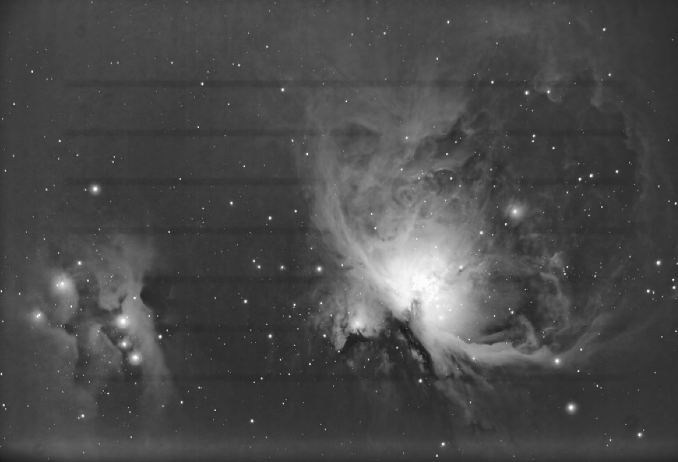

I don't know if this helps but I have an Canon 750D and also have lines, there are 7 broad lines that can be seen on the sencor directly, see http://www.cloudynights.com/topic/512886-canon-banding-help/page-3.
I don't use a memory card on the camera as I have it connected directly to the computer when I am using it in astrophotography so it got nothing to do with a memory card. Many seems to have this problem with 750 and 760D and it seems like an issue with the sensor itself. If I sort the pic in channels it is worse in the blue channel.
Cleaning the sensor will not cure this. I am about to have mine replaced with another model.
Jim
