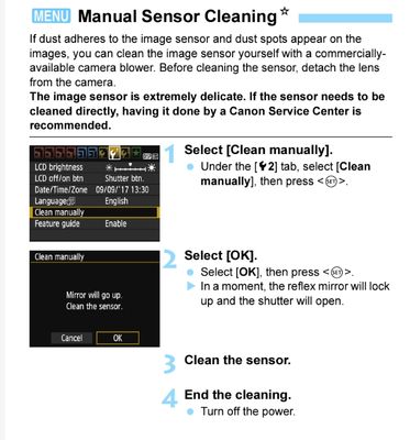

I have a dark colored smudge that shows up when light colored pictures (ex. sky) are taken. Do I have dust on my sensor? And if so, how do I clean or remove it? I have a Rebel T100 camera.

@ClickAD wrote:I cannot get to the sensor. The camera does not have a way to lock up the mirror. Can I go to video mode to lock up the mirror.
Make sure you are in a Creative Zone
Then, when you press the Menu button, you should see this selection in the Wrench 2 menu.
Newton

12-21-2023 01:07 PM
Do you have an air blower (hand-squeezable style)? If so, lock up the camer's mirror, remove your lens, and blow out the camera's interior.
If that doesn't resolve the issue, I would recommend sending it in to Canon for cleaning.
12-21-2023 10:03 PM
The instructions in the manual are not correct. The camera does not have a clean manually function in the camera menu as indicated in the instruction manual. Is there another way to lock up the camera's mirror? Can I set the camera to video mode the lock up the mirror?
12-21-2023 04:55 PM
You can LOOK at the sensor to see if anything is on it. But other than carefully blowing off dust with a squeeze-bulb blower, it is not advisable for you to clean the sensor. You can damage it too easily.
12-21-2023 10:05 PM
12-21-2023 11:00 PM
Try it.
12-22-2023 01:54 AM
Newton
