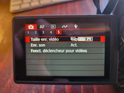

03-15-2024 05:38 PM - edited 03-15-2024 05:39 PM
Why on my R8 I don't have all the setting... strange? I cannot go at the function custom 4 because it's not there...
Do you know why?
