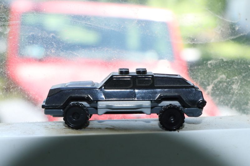

I'm including this just for illustrative purposes. I shot this at f/11 from about 2 feet away, with a shutter speed of 1/160, and ISO of 1000. The little car is in focus, but the jeep behind it is just a blur.
Steve Thomas
